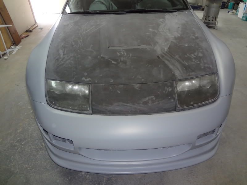

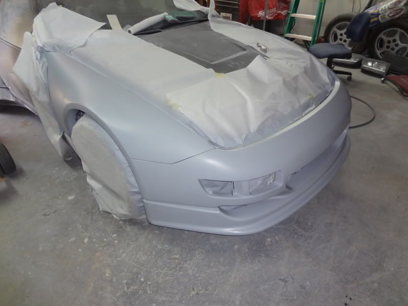

Front widebody is pretty much complete. Approx 1.5" per side wider than stock. SPL 20mm wide fenders modified with additional ~3/4" wider/side. Escort fasica cut and widened to match the flow of fenders.
Will post more pics when I arrive in Texas to check it out in person.
Rear is getting changed a bit because the shape didn't come out like I wanted. I am however; pleased with how the front came out.
